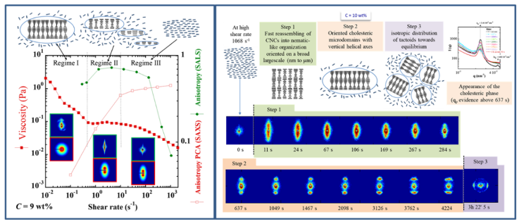

For CNC suspensions, several advances were obtained regarding flow properties and the mechanisms of shear-induced destructuring and restructuring upon flow cessation. notably, SALS measurements revealed for the first time that in the shear-thinning regime I, large cholesteric domains of the liquid-crystalline phase are progressively fragmented into micrometric tactoids, with their cholesteric axis aligned perpendicularly to the flow direction. Even more originally, SALS showed that upon flow cessation, the relaxation process proceeds via a three-step restructuring mechanism: (i) rapid reassembly of individual CNC into a nematic organization established up to micrometric scales, (ii) slower formation of large, oriented cholesteric domains through a nucleation-and-growth process, and (iii) their isotropic redistribution.
Multi-scale characterization of the destructuring and restructuring mechanisms of a cellulose nanocrystal suspension probed in situ by SAXS and SALS and correlated with viscosity changes.

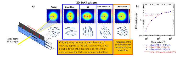

In another study, where we aimed to combine shear flow and ultrasonic wave excitations, it was shown that ultrasonic waves in a confined medium generate a slow motion associated with a phenomenon called Rayleigh acoustic streaming, which induces alignment of cellulose nanocrystals (CNC) with their director oriented along the propagation direction of the acoustic waves.
During the combined action of shear and ultrasound, by adjusting the intensity of the shear gradient and the ultrasonic power simultaneously applied to CNC suspensions, it was possible to control both the direction and the degree of CNC orientation over time. This ability to manipulate CNC orientations along different directions using shear or ultrasonic forces has been used to develop cellulose-based nanocomposites with lamellar or orthotropic structuring for applications in optics, photonics, and tissue engineering.
(a) Combined effect of a shear gradient and ultrasonic waves on CNC orientation, revealed by in situ SAXS. (b) Comparison of the orientation effect induced by shear alone versus shear combined with ultrasound.

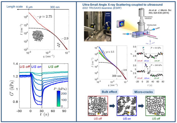

Although ultrasound is widely used at high power to disperse particles in a suspension or to cut soft materials with vibrating blades, no fundamental study has yet precisely detailed its effect on the mechanics of soft solids. This experimental work, employing in situ ultra-small-angle X-ray scattering (TRUSAXS), demonstrates the possibility of probing, over an uncommon wavevector range at the micrometer scale, the effect of ultrasonic waves on colloidal gels composed of carbon black particles dispersed in mineral oil. It was shown that ultrasound above a critical amplitude induces a complex transient viscoelastic response of the gels within seconds: a reduction of the elastic modulus accompanied by a strong increase in the loss modulus. Through in situ TRUSAXS observations, these macroscopic effects were attributed to the formation of intermittent microcracks within the gel bulk, for which fractal-type organizational changes could be revealed.
Dagès, N., Lidon, P., Jung, G., Pignon, F., Manneville, S., & Gibaud, T. (2021). Mechanics and structure of carbon black gels under high-power ultrasound. Journal of Rheology, 65(3), 477-490.
Gibaud, T., Dagès, N., Lidon, P., Jung, G., Ahouré, L. C., Sztucki, M., ... & Manneville, S. (2020). Rheoacoustic gels: Tuning mechanical and flow properties of colloidal gels with ultrasonic vibrations. Physical Review X, 10(1), 011028.

Pignon, F., Challamel, M., De Geyer, A., Elchamaa, M., Semeraro, E. F., Hengl, N., ... & Djeridi, H. (2021). Breakdown and buildup mechanisms of cellulose nanocrystal suspensions under shear and upon relaxation probed by SAXS and SALS. Carbohydrate Polymers, 260, 117751.

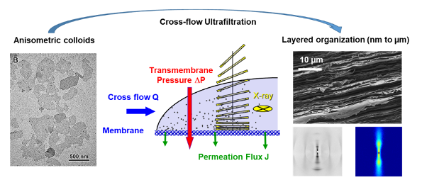

An original characterization of the structural organization of the concentration polarization layer (CPL) during the tangential filtration of anisotropic colloidal suspensions was carried out through the development and implementation of dedicated filtration cells for in situ SAXS measurements. The combination of in situ SAXS, in situ PIV, and ex situ TEM enabled the revelation of the CPL’s organization into oriented, homogeneous lamellar layers across length scales ranging from nanometers to micrometers.
The uniqueness of the structural parameters obtained from in situ SAXS measurements during tangential ultrafiltration allows for a detailed discussion of the potential relationships between filtration parameters (thickness, resistance, and permeation flux) and physical characteristics (volume fraction, orientation, shape, and aspect ratio). This new approach opens perspectives for nanometer-scale characterization methods to better understand fouling phenomena in membrane separation processes and the stability of concentration polarization layers.
Mandin, S., Metilli, L., Karrouch, M., Blésès, D., Lancelon-Pin, C., Sailler, P., ... & Pignon, F. (2024). Multiscale study of the chiral self-assembly of cellulose nanocrystals during the frontal ultrafiltration process. Nanoscale, 16(40), 19100-19115.
Rey, C., Hengl, N., Baup, S., Karrouch, M., Gicquel, E., Dufresne, A., ... & Pignon, F. (2019). Structure, rheological behavior, and in situ local flow fields of cellulose nanocrystal dispersions during cross-flow ultrafiltration. ACS Sustainable Chemistry & Engineering, 7(12), 10679-10689.
Semeraro, E. F., Hengl, N., Karrouch, M., Michot, L. J., Paineau, E., Jean, B., ... & Pignon, F. (2020). Layered organization of anisometric cellulose nanocrystals and beidellite clay particles accumulated near the membrane surface during cross-flow ultrafiltration: In situ SAXS and ex situ SEM/WAXD characterization. Colloids and Surfaces A: Physicochemical and Engineering Aspects, 584, 124030.
In situ monitoring of structuring by SAXS during the tangential filtration of beidellite clay suspensions: evidence of homogeneous, oriented lamellar structuring.
